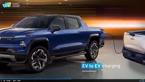

Did anyone see any details anywhere on vehicle to vehicle charging? They mentioned it in the presentation with the use of an accessory cord...the video shows a connection from the charge port on the Silverado to the other charge port. They don't show the connector type but I'm assuming it's J1772 for AC charging (would DC V2V charging even be possible?). Given that the max power output of the outboard power system is 10kW this seems interesting.
With the Ford Lightning, you need to use the recipient vehicle's mobile charger - typically 110v, limited 10 or 15 amps for a total of 1100-1600 Watts or so. If you had the Pro Power plus option on the Lightning and a 220v portable charger that could handle 48 amps, you could get the max of 9kW V2V charging. With the Silverado, it appears you could get 10kW to any j1772 vehicle without using their portable charger.
